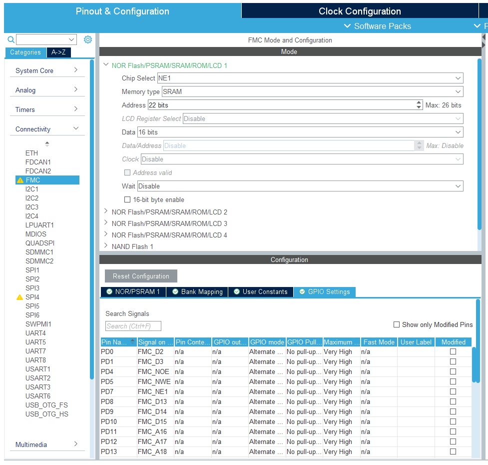

I need to use an SRAM with the STM32H743AII6 MCU. When I try to configure the project on CubeMX, a warning appears next to the FMC line. I feel like I should fix this before going further with the configuration.
I am curious why I am getting this warning even when FMC is the only peripheral that was already configured. Has anybody experienced this before? Are there any suggestions to resolve this?
Here is a summary as background information:

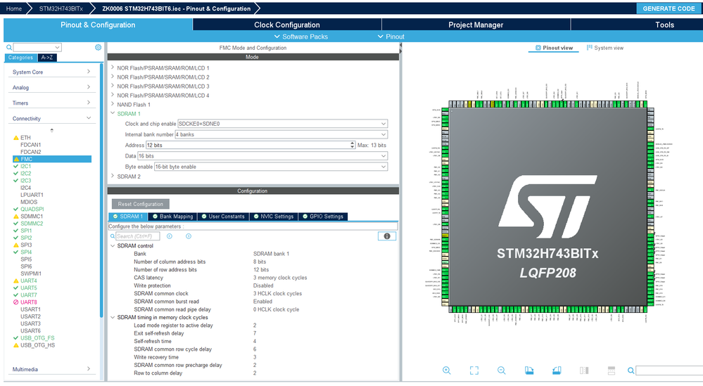

see my configuration I have the same chip connected to IS42S16400J-7TL (SDRAM 64 Mbit )
all is working fine

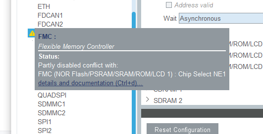

What message is showing when you pass the mouse cursor on the warning icon?
2024-04-15 4:36 AM
Hi SofLit,
Here is the message:

2024-04-15 5:01 AM - edited 2024-04-15 6:13 AM
I think you can go ahead and ignore that warning.
If you notice any missing in the FMC config in the generated code, you can notify us.
2024-04-15 5:33 AM
all is working fine
2024-04-16 3:44 AM
Dear MNapi and SofLit,
Thank you for your answers, you've been so helpful. I'll proceed with my design.

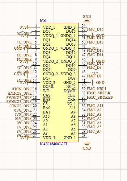

2024-04-16 7:14 AM - last edited on 2024-04-16 7:56 AM by mƎALLEm
if you want to use the same memory chip
you need to initialize it:
