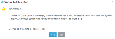

Did you get this warning message? and clicked "Yes"?
You need to change HAL time base source othr than Systick Ex: TIM7.

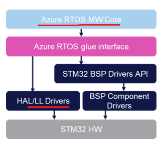

1. Then, can you not use LL ?
2. Must we use another timer (not a systick)?
Or both?
2024-04-16 11:35 AM - edited 2024-04-16 11:38 AM
According to the following figure from this link no restriction to use LL:
When using RTOS you need to select another timer for the driver and systick is reserved for RTOS timebase.
