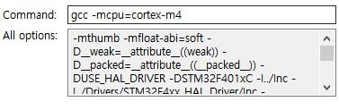

my compiler is gcc and option as this:
2019-12-22 4:13 PM
this option are generated by CubeMX except -mcpu option

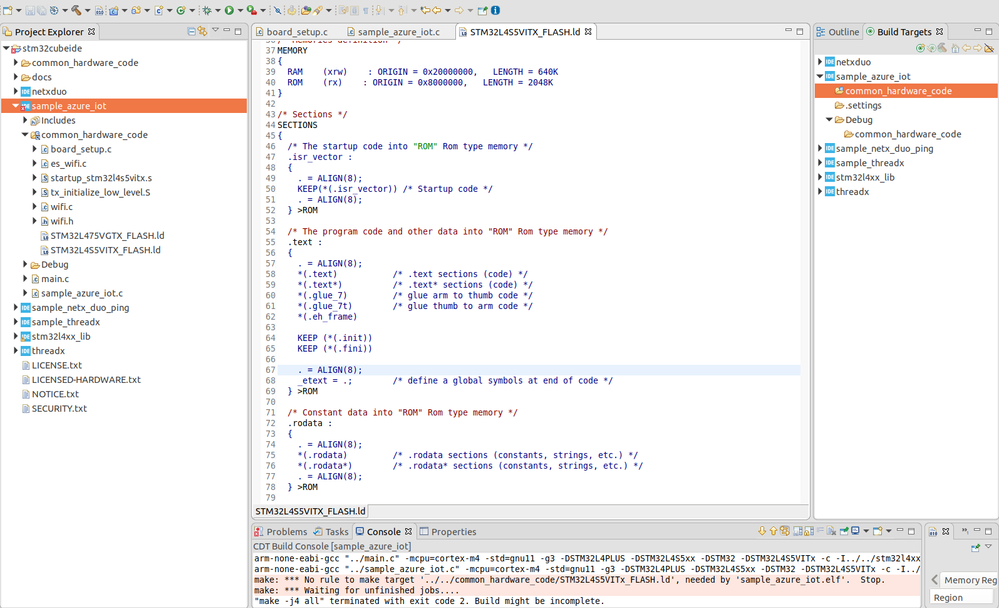

2020-10-10 9:43 AM
I am trying to run the sample_azure_iot project and get this same error in stm32cubeide. Any idea what could be wrong? I downloaded the sample directly from: https://github.com/azure-rtos/samples
