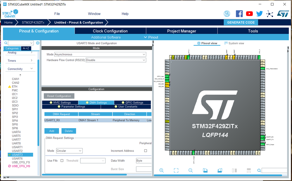

2020-10-02 4:29 AM
here in cubemx there is a option called FIFO , please help me how to use the option in your code. If there is any tutorial or study (or) reference materials please kindly share that also.
2020-10-02 5:53 AM
In general it is pretty transparent.
Where things are subtly different is being aware it has depth greater than One, so you'd use while(TXE==1) rather than if (TXE == 1) type constructs.
2020-10-02 7:31 AM
1.1.9 DMA FIFO mode
Each stream has an independent 4-word (4 * 32 bits) FIFO and the threshold level is software-configurable between 1/4, 1/2, 3/4 or full.
The FIFO is used to temporarily store data coming from the source before transmitting them to the destination.
DMA FIFO can be enabled or disabled by software; when disabled, the Direct mode is used.
If DMA FIFO is enabled, data packing/unpacking and/or Burst mode can be used.
The configured DMA FIFO threshold defines the DMA memory port request time.
The DMA FIFOs implemented on STM32F2/F4/F7 devices help to:
• reduce SRAM access and so give more time for the other masters to access the bus matrix without additional concurrency,
• allow software to do burst transactions which optimize the transfer bandwidth,
• allow packing/unpacking data to adapt source and destination data width with no extra DMA access.
Source: AN4031 Application note Using the STM32F2, STM32F4 and STM32F7 Series DMA controller
2020-10-09 7:54 AM
Hi @Sprak.1
The AN4031 explains more this option "fifo"
Best regards,
Nesrine
