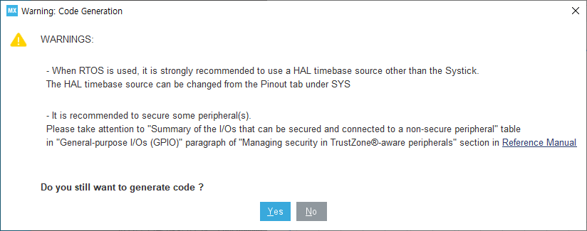

I want to generation code with FreeRTOS in Trustzone at STM32L562ZET6Q.
I want to use FreeRTOS in Non-Secure Zone.
So, I enabled FreeRTOS in Middleware division.

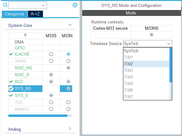

And, I want to change about Timebase Source in SYS_NS.
But, all timers are disabled(inActive) except SysTick.
So, there occur warning message about SysTick when run code generation.

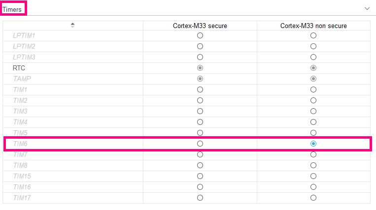

2022-12-13 6:15 AM
Hello @JongOk Baek,
You can change the Timebase source in SYS_NS by enabling the dedicated timer as shown in the below figures.
I advise you to get inspired from the available freeRTOS examples in the STM32CubeL5 MCU package.
