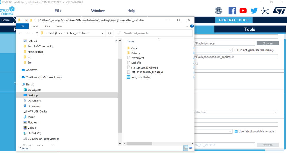

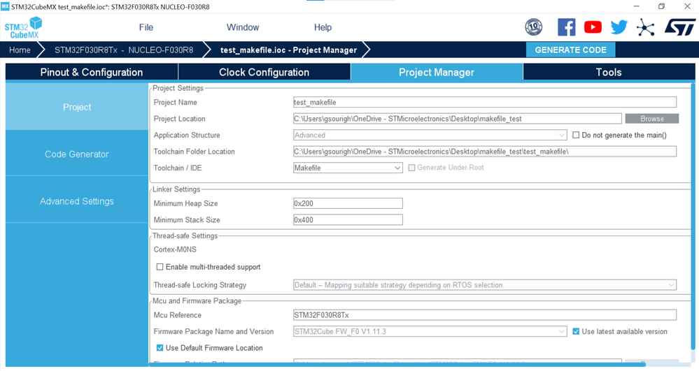

2022-11-04 3:33 AM
Hello @paulojfonseca
I tried to reproduce the same behavior you encountered but it works fine from my side.
Please take a look
I choose the Makefile as a Toolchain /IDE
Then i changed the Project Location
Finally, i generated the code
Thx
Ghofrane

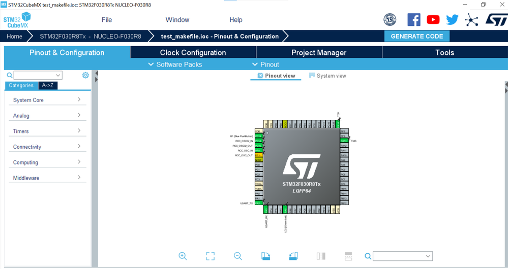

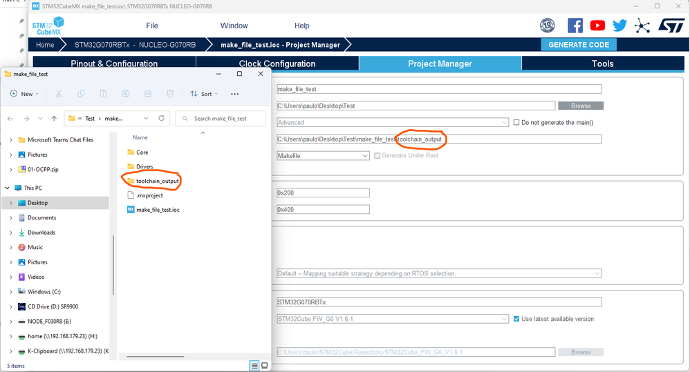

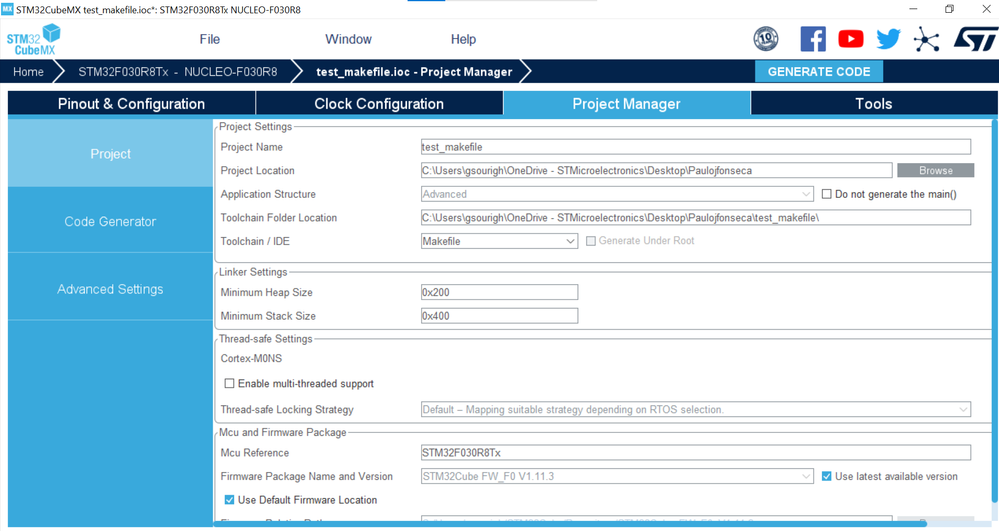

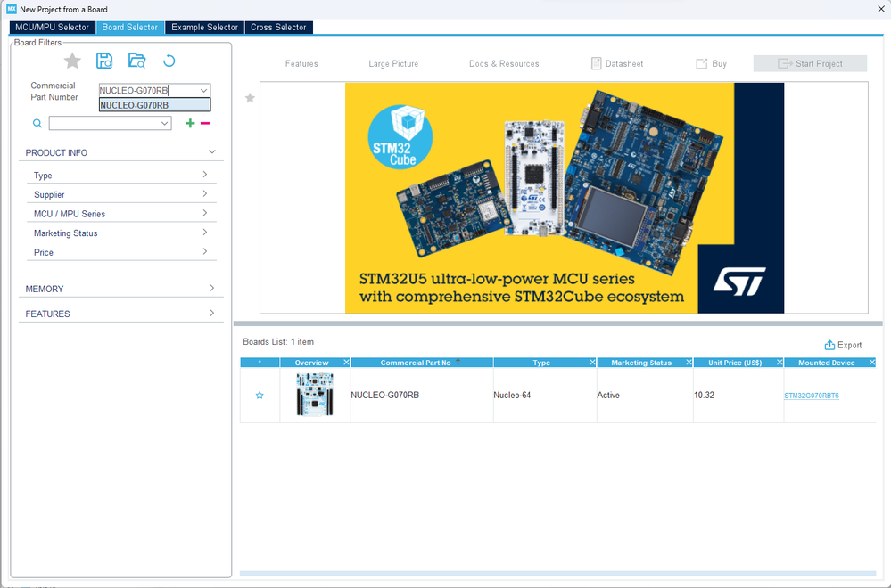

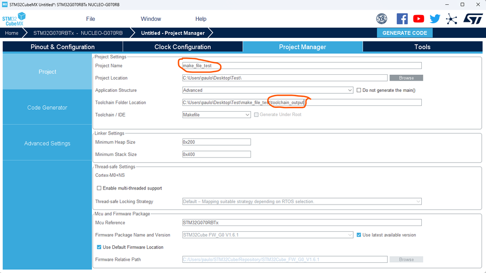

2022-11-04 5:35 AM
Hi Ghofrane,
Looks like was not clear in the steps for reproduction.
Let me try and do it again with images:
1 Open CubeMx and create a new project (used Nucleo Board, but also experienced the same with MCU selection)
2 Go to project management and choose: Project Name, Project Folder, Toolchain Folder and Makefile Toolchain IDE
3 Generate Code (until here all goes ok according the instructions)

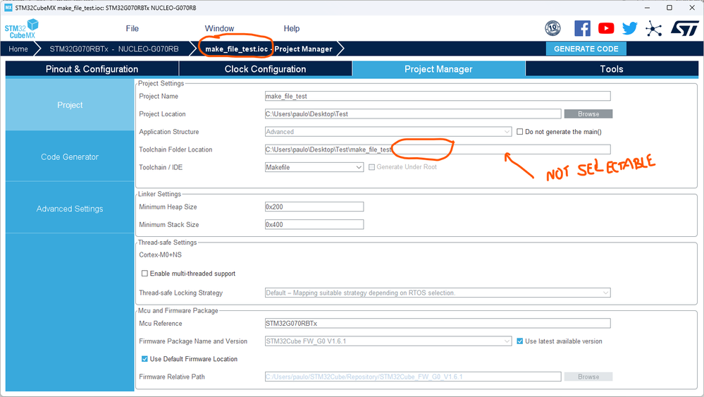

4 Close CubeMx
5 Reopen CubeMx with the previously created project.
6 Go to Project Management. Now you can experience the problems i am facing.
Bug 1 - The previously Toolchain folder is gone.
Bug 2 - I cannot re-type it again because the text box is not enabled.
Bug 1 i cannot overcome.
Bug 2 i can if i select Toolchain EWARM, change the toolchain folder, select Makefile again
Hope that you can now reproduce it.
