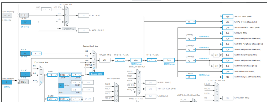

2025-07-21 10:51 AM - edited 2025-07-21 12:51 PM
Thanks for your help. I am a total beginner so maybe I am completely missing the obvious but I think this is for another board / setup. I think the h753zi cant do 480 mhz.
Also I am wondering. The board doesn't seem to have a quartz. I tried two nights configuring but had lots of jitter / drifting clocks.

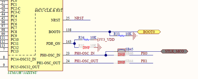

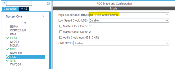

2025-07-21 2:04 PM
If you are using a NUCLEO-H753ZI then there are no external crystals but there is the MCO clock from the ST-Link.
You have to set up for High Speed Clock HSE
Only the CPU clock can run at 480MHz. The peripheral clocks can only run at 240/120MHz.
