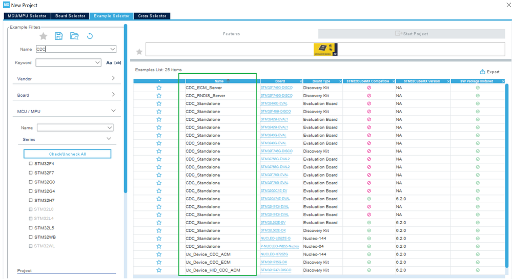

Meanwhile, the Example selector allows you to browse a large set of CDC examples and to start a project based on a selected example. Those examples may be a good start point to successfully create your project:
