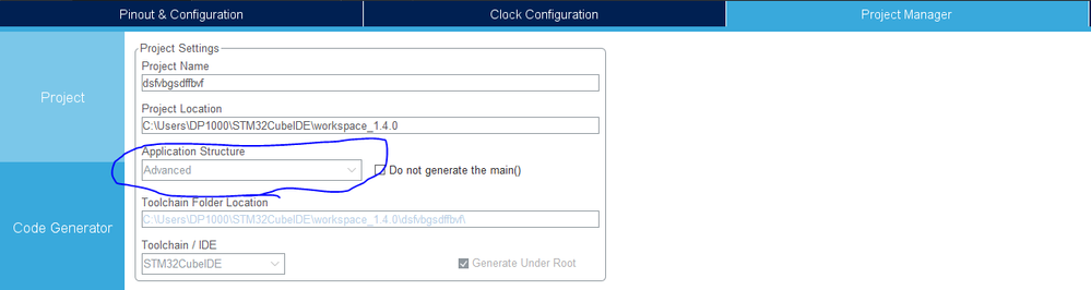

Hello, i cannot change Application Structure to Basic in STM32CubeIDE V 1.4.2

Hello Markus,
i was meaning the application Structure that is in the project manager in the .ioc file.
Sorry for not being detailed and for my bad english.

I'm not as knowledgeable about CubeMX (I'm in the CubeIDE team) but it seems that this is a known bug according to this thread.
It seems that you can use the stand-alone CubeMX tool to select Basic Application Structure and then generate a project for CubeIDE.
