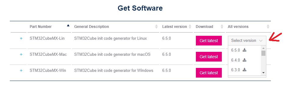

You can download CubeMx separetly from this link and generate code for CubeIDE. Go to "Select version" menu to download an older version:
You can open a new thread for the latest issue you reported.
Thank you for your understanding.

Thank you, I have Cube MX v6.4.0 installed separately now. If I wish to use CubeMX from within CubeIDE (which is how I have been using it so far) the downloaded file for v1.8.0 seems broken. Please can you check this file please?

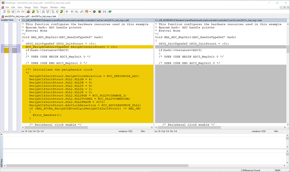

I have been fighting against the same problem for the last few weeks. At one point in time, the ADC clock was miraculously turned on in CubeMX. Instead of fighting another battle against CubeIDE/CubeMX installation, I saved the working version of the stm32h7xx_hal_msp.c and reused it over the new one created by CubeMX.
Attached are the diff screenshot and function code.
void HAL_ADC_MspInit(ADC_HandleTypeDef* hadc)
RCC_PeriphCLKInitTypeDef PeriphClkInitStruct = {0};
if(hadc->Instance==ADC3)
/* USER CODE BEGIN ADC3_MspInit 0 */
/* USER CODE END ADC3_MspInit 0 */
/** Initializes the peripherals clock
PeriphClkInitStruct.PeriphClockSelection = RCC_PERIPHCLK_ADC;
PeriphClkInitStruct.PLL2.PLL2M = 4;
PeriphClkInitStruct.PLL2.PLL2N = 9;
PeriphClkInitStruct.PLL2.PLL2P = 4;
PeriphClkInitStruct.PLL2.PLL2Q = 2;
PeriphClkInitStruct.PLL2.PLL2R = 2;
PeriphClkInitStruct.PLL2.PLL2RGE = RCC_PLL2VCIRANGE_3;
PeriphClkInitStruct.PLL2.PLL2VCOSEL = RCC_PLL2VCOMEDIUM;
PeriphClkInitStruct.PLL2.PLL2FRACN = 3072;
PeriphClkInitStruct.AdcClockSelection = RCC_ADCCLKSOURCE_PLL2;
if (HAL_RCCEx_PeriphCLKConfig(&PeriphClkInitStruct) != HAL_OK)
Error_Handler();
/* Peripheral clock enable */
__HAL_RCC_ADC3_CLK_ENABLE();
__HAL_RCC_GPIOF_CLK_ENABLE();
/**ADC3 GPIO Configuration
PF10 ------> ADC3_INP6
GPIO_InitStruct.Pin = GPIO_PIN_10;
GPIO_InitStruct.Mode = GPIO_MODE_ANALOG;
HAL_GPIO_Init(GPIOF, &GPIO_InitStruct);
/* ADC3 interrupt Init */
HAL_NVIC_SetPriority(ADC3_IRQn, 5, 0);
HAL_NVIC_EnableIRQ(ADC3_IRQn);
/* USER CODE BEGIN ADC3_MspInit 1 */
/* USER CODE END ADC3_MspInit 1 */

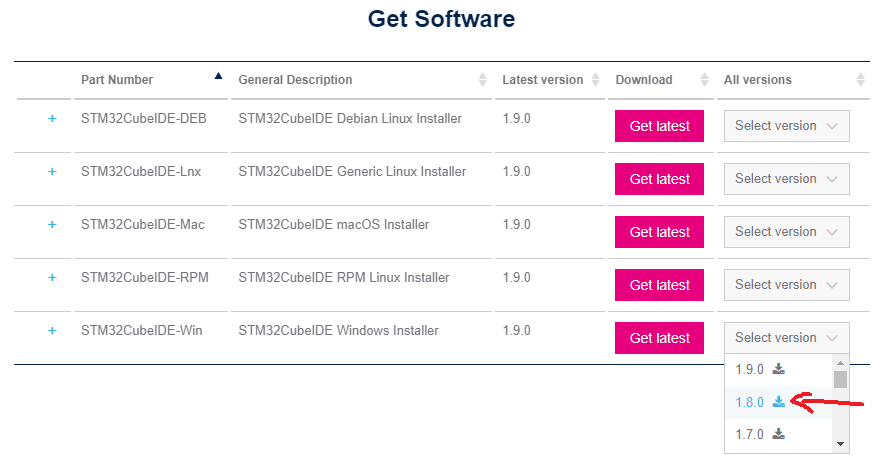

2022-04-11 11:50 PM
Thank you for your help, I'm sure this will help others who find this post.
Following the advice of SofLit I'd downloaded V1.8 of the CubeIDE; the download now appears to now have been fixed.
en.st-stm32cubeide_1.8.0_11526_20211126_0815_x86_64.exe_v1.8.0.zip
