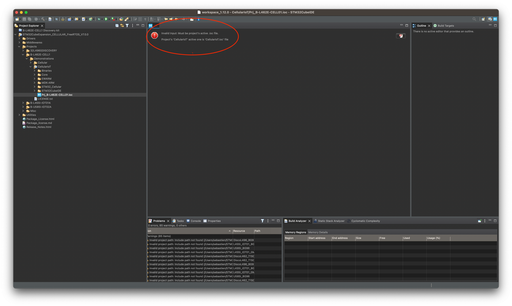

When importing the X-CUBE-CELLULAR into my project explorer I can't open the IOC file to see how the freeRTOS was setup.
_legacyfs_online_stmicro_images_0693W00000dJqLeQAK.pngMaybe I'm not supposed to import X-CUBE-CELLULAR that way but how could I know? the getting started guide doesn't explain anything!

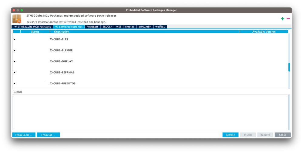

I've read on some other guides that expansion package are usually installed using the: "Help>Manage Embedded Software Package"
_legacyfs_online_stmicro_images_0693W00000dJtnqQAC.pngAnd I see a lot of X-CUBE-SOMETHING here but CELLULAR is nowhere to be found.

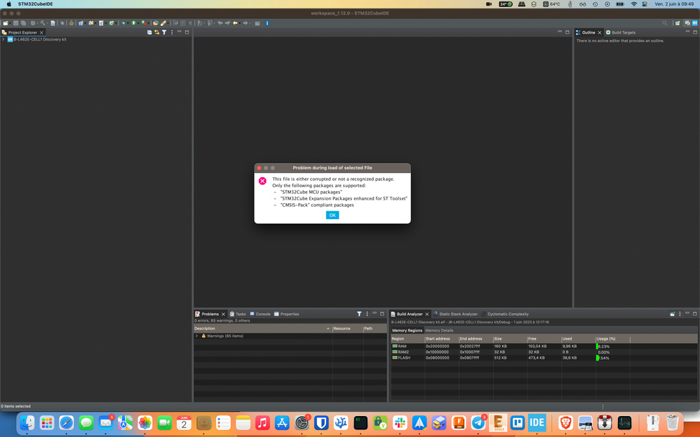

So I decided to use the "From Local" option
_legacyfs_online_stmicro_images_0693W00000dJtoAQAS.pngPlease can someone explain to me how are you supposed to use this X-CUBE-CELLULAR package? I feel really dumb since I'm assuming this should be really obvious since there isn't any written guide about this?
