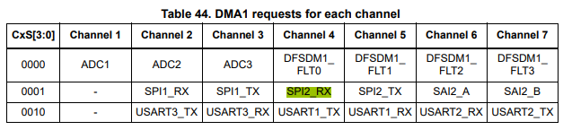

I just fixed the bug after discovering this statement:
LL_DMA_SetPeriphRequest(DMA1, LL_DMA_CHANNEL_4, LL_DMA_REQUEST_4);
The datasheet indicated SPI2-RX goes to DMA_CHANNEL_4 and also DMA_REQUEST_4 but when MXCube creates code it points to LL_DMA_REQUEST_1 not LL_DMA_REQUEST_4 as per datasheet s
It is in reference manual RM0351 Page 338 (STM32L47xxx, STM32L48xxx, STM32L49xxx and STM32L4Axxx) which clearly link SPI2_RX to LL_DMA_REQUEST_4 so I still confused between LL_DMA_REQUEST_4 and LL_DMA_REQUEST_1 is reference manual in error?.
Can anyone explain this?

Hi @Community member ,
Generated code with current STM32CubeMX version (6.6.1) contains following line:
LL_DMA_SetPeriphRequest(DMA1, LL_DMA_CHANNEL_4, LL_DMA_REQUEST_1);This is aligned with the content of table 44 in the RM0351:
Are you sing an older version of the tool where it is possible that there was an issue?
