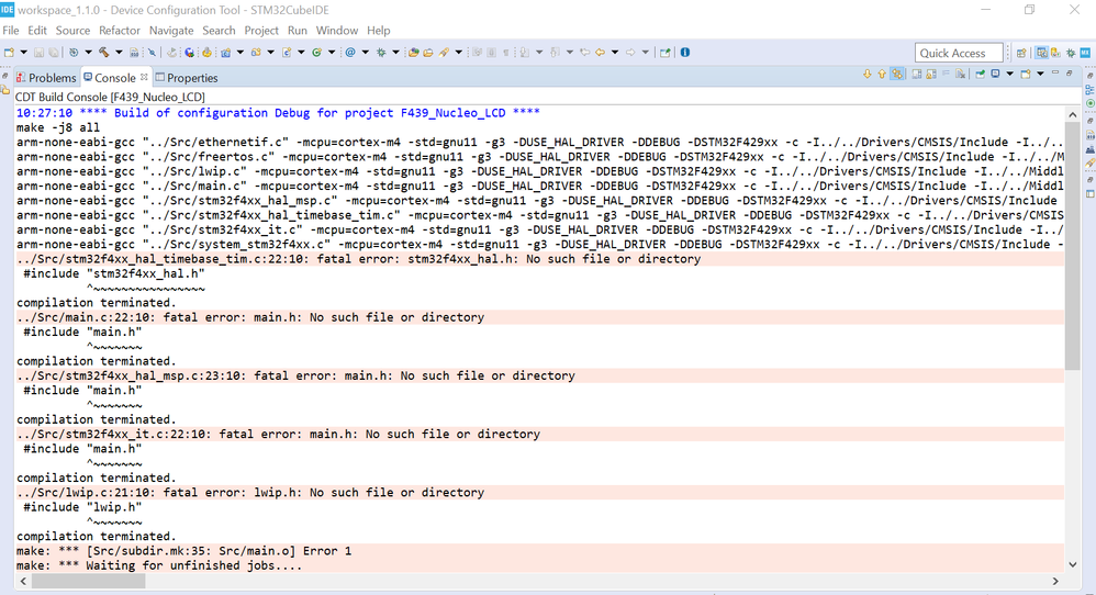

Update: Complete bad generated project attached, picture of build failure added.
Note this problem is produced with the CubeMX plug-in inside the IDE, not the stand-alone CubeMX.
F439, latest CubeIDE, included RubeMX 5.4.0, and HAL/LL stuff all downloaded in last couple days.
Attached IOC generates code with many bugs:
This is absolutely, absurdly, and completely broken.
Has anybody ever tested any of this software?
STM, Please confirm you have reproduced the above problems and filed at least 150 tickets,
Thanks,
Best Regards, Dave
Build results:

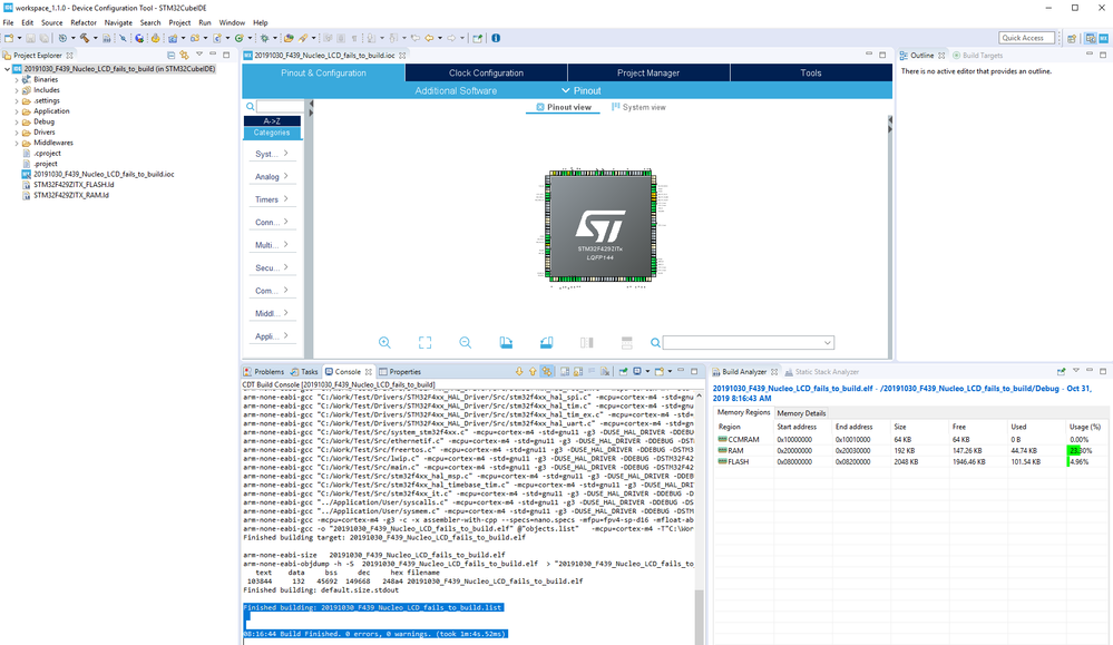

I'm pleased to say relying on your shared .ioc file all is just working nice. I've got a try relying on latest STM released material (MX 5.4.0 & CubeIDE 1.1.0 pair).
1) I've generated CubeIDE project starting from CubeMX (just doing "File>Load" then "Generate Code")
2) I've imported then such project within CubeIDE
3) I've just build it …. leading to compile process success !!!
Process sounds to me quite obvious & functional.

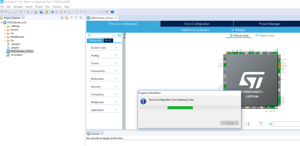

Now let's play with CubeIDE ONLY:
1) Create a brand new common Eclipse project/ File > New Project then General Project type
2) Mandatory to set as project name the same you have within your .ioc file (not your .ioc file name … takes care): F439_Nucleo_LCD
3) Let's copy your .ioc file within such project setting same file name as your project name: F439_Nucleo_LCD.ioc
4) Double click on such .ioc file … .ioc editor should open
5) Let's request code generation then ...
6) You're done … let's compile …. on my side leading back to compile success

@Markus GIRDLAND, @Amel NASRI, @Cartu38 OpenDev - I confirm that if the standalone version of CubeMX 5.4.0 is used to generate the project, it compiles AOK as @Cartu38 OpenDev mentions above. Unfortunately, the CubeMX 5.4.0 plug-in within the STM32CubeIDE generates the non-working project as above. So work-around for now is use the standalone version.
