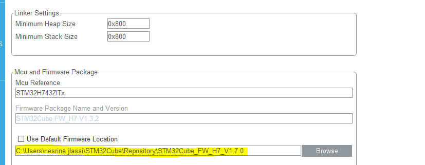

Hi @jakob.brunhart
You are using an older version of the firmware.
Try this version of Firmware Package "STM32Cube_FW_H7_V1.7.0", it works correctly.
Best regards,
Nesrine

Hi Nesrine
Thank you.
Regards
Jakob
