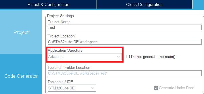

It's not possible to change the application structure in STM32CubeIDE v1.1.0.
STM32CubeMX v5.4.0 is installed.
The option "Advanced" is always used on every new created projects.

2019-10-22 5:34 AM
You're right @AScha.381 , Issue will be fixed in the next release.
Thanks for bringing this bug to our attention .

2019-10-23 5:19 AM
Dear @AScha.381 ,
After discussed with team :
When starting the project, CubeIDE starts a “CubeMX�? project. And the project structure must be frozen at the beginning.
We have considered that it will be easier for our customers to start with a default “advanced�? structure, which is more “future proof�? for your design rather than to ask the enigmatic question to most of our customers. ( so maybe this will not be fixed in the next release :\ ).
Otherwise, if you need the basic Application structure* please start your project with CubeMX then generate CubeIDE code.
