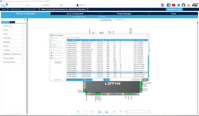

I am trying to port my preconfigured H743 Nucleo board pinout setting to H753ZI Nucleo board, which is pin to pin compatible. I clicked the "list compatible MCU" under the pinout tab, but for some reason, the window just stuck in the loading process forever. Please see the picture below:
The progress stuck at exactly 70%, I can see the MCU I want, but I couldn't click on it because the loading is not done. Any idea on how I can fix this? Thanks for any suggestion in advance.

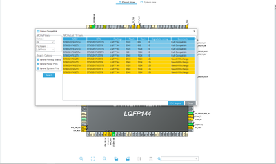

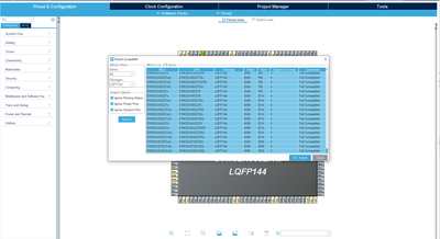

Hello @Maxer
I've tested For the STM32H743ZITx:
and for the STM32H563ZIT6:
And it works fine. Please update your CubeMX to the last versions (V 6.11.0).
