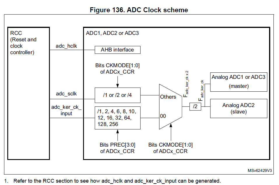

I used STM323H742VGT in one of my cards and I would like to configure it with ST Cube MX V6.5.0. According to the reference manual ADC clock source and pre-scaler can be set using ADCx_CCR register.
I would like to use asynchronous clock source which is adc_ker_ck_input. However, I couldn't find any setting in ADC section of CubeMX. There aren’t any settings also for pre-scaler. I am familiar with STM32F7 and I could select pre-scaler over Cube MX.
On the other hand, ADC_Clock is not enabled in Clock Configuration page in Cube MX. I don't know why. Normally, if I set a peripheral, related clock is enabled and I can change parameters in Clock configuration page.
I added some screen shuts and if you can help me, it would be great. If I cannot set in ST cube MX, I need to write driver for it. I prefer ST Cube MX should do it for me. I may miss one thing to set and spend days to figure out.

Thank you very much for the information. I understood the known issue is about ADC_Clock(+ADC Mux) in Clock configuration page of Cube MX. What about ADC clock source selection and pre-scaler. There is not any setting in ADC Settings under Pinout&Configuration page. According to Reference Manual, we can select asynchronous or synchronous clock source by setting CKMODE bits in ADCx_CCR register. This should be set in ADC Settings of Cube MX and if asynchronous clock input is selected, pre-scaler should be set as well (PRESC[3:0] bits of ADCx_CCR).
Can you provide a sample code or driver which is about RCC and ADC settings in code level while Cube Mx will be fixed. I believe Cube MX cannot generate correct code for it. To be honest I can develop such code but H7 is complex comparing F4/F7 series.There are 3 power domains and so on. ADC1 and 2 are in the same domain and ADC3 is in another domain. I don't want to miss any settings.
