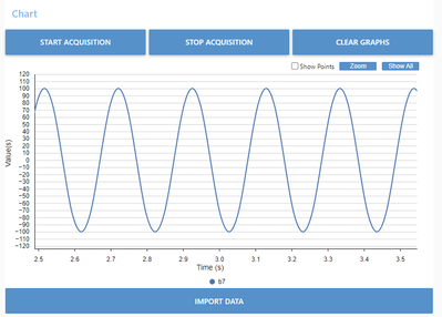

I display b7 in STM32CubeMonitor, and that's how I see how long it takes for 100K main loops, or how many main loops are performed per second.

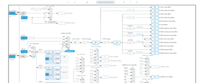

Clock Configuration:
I did the test for the Core-M7 and the Core-M4, and these are the results:
Core-M7:
About 1.666M loops per second.

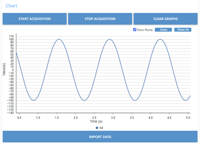

Core-M4:
About 60K loops per second.
The results are so far from each other (I expected a 2x ratio between them).

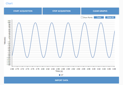

I opened a new project (No code except the test) and ran the same test for each core, here are the results:
Core-M7:
About 500K loops per second, 3x slower at loop rate!!

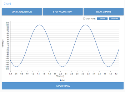

Core-M4:
About 75K loops per second.
