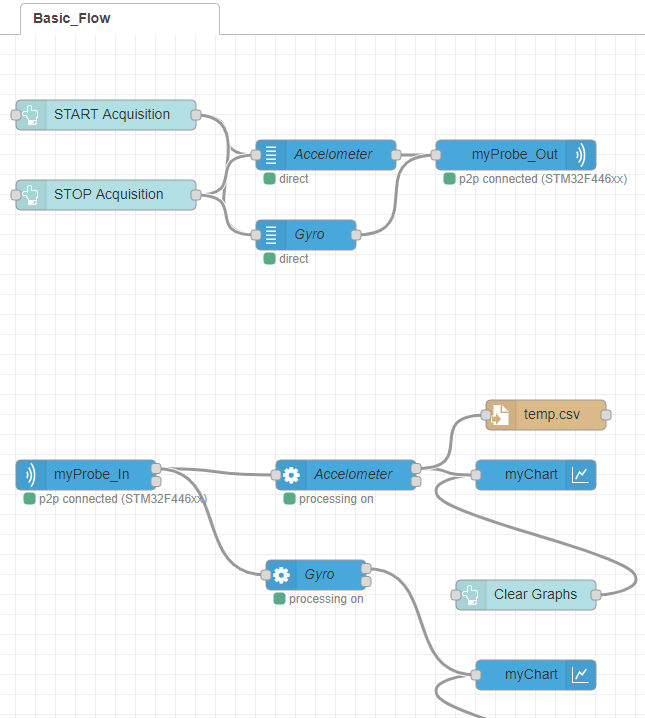

2020-09-29 7:12 AM
Hi yang2
I'm also newcomer, and faced similar problem.
I'm not sure this is correct way, but I exported variable data as the following way.
{"groupname":"Accelometer","variabledata":[{"y":9088,"x":1601387630428},{"y":9160,"x":1601387630442},{"y":9112,"x":1601387630458},{"y":9108,"x":1601387630472}],"variablename":"mpu1.Accelerometer_X"}
{"groupname":"Accelometer","variabledata":[{"y":-14248,"x":1601387630428},{"y":-14196,"x":1601387630442},{"y":-14240,"x":1601387630458},{"y":-14228,"x":1601387630472}],"variablename":"mpu1.Accelerometer_Y"}
{"groupname":"Accelometer","variabledata":[{"y":6168,"x":1601387630428},{"y":6256,"x":1601387630442},{"y":6252,"x":1601387630458},{"y":5996,"x":1601387630472}],"variablename":"mpu1.Accelerometer_Z"}

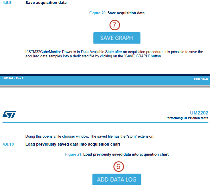

"how can I save .stpm file?"
Hopefully, after 7 months, you have worked it out?
For the benefit of others, press this button:
The name is a bit misleading: it doesn't just save an image of the graph - it does save the captured data to a .stmp file.
This is documented in the User Manual:
