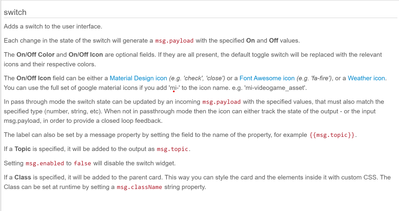

You can find  the node help on the right side of the flow when selecting it (see below). Switch node is not a ST specific node and there's probably some more information in the node-red documentation.
