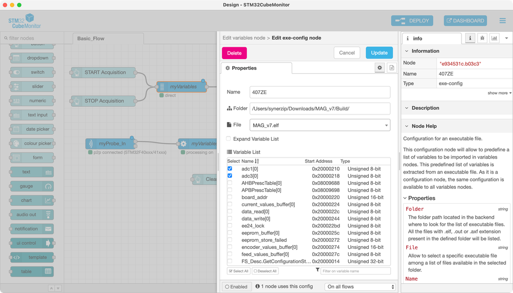

This might seem like a noob Q but how can I monitor an array in Cube Monitor? I find it really confusing and as the screen shot below shows, I can only see the 0th element of the array but not the others. Am I missing something?

Hello
You need to click the checkbox "Expand Variable List" to see the elements of the array.
Best regards
Stephane
