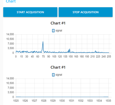

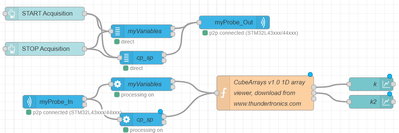

Following flow is my test-flow blocks. Cube-array block was referenced from above link.
When I tried to draw double graphs, I can see only one graph is updated.
(following is captured image, where upper graph is updated but bottom graph is not updated.)
I attached exported json file of above flow-blocks.
Is there any way to view multiple array graphs?

Hello @Tiel
did not check your flow in details but sounds that the second graph is updated with an always zero value.
