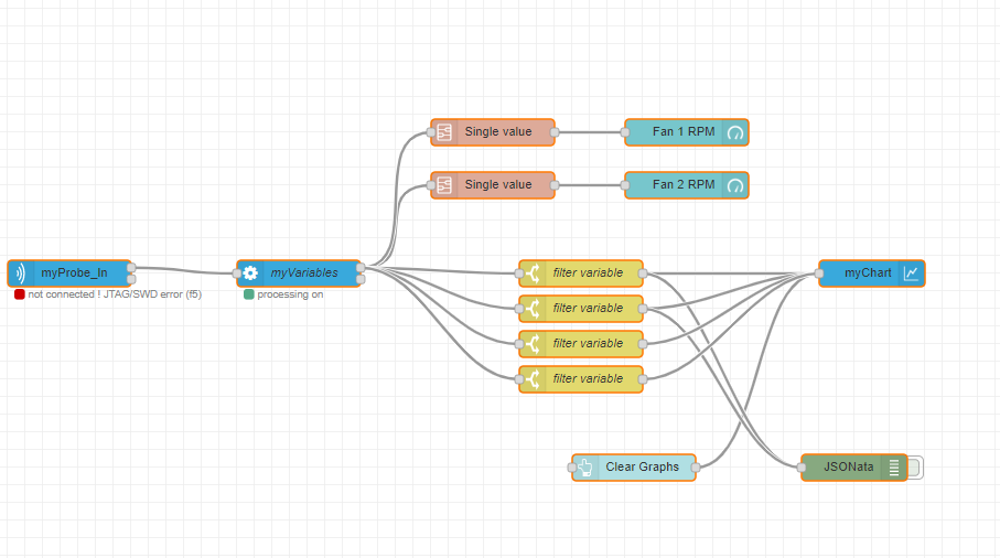

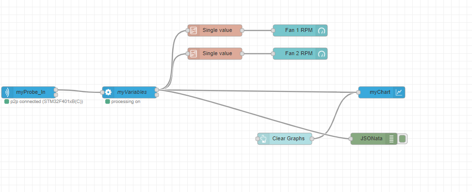

I think it is a basic question but I can't find a solution.
I read 4 variables, 2 fan RPM and 2 temperatures.
I route the two RPM to a gauge, and I would like the temperature to a char (only the temperature). Because the scale is very different.
Gauge is working, I can filter.
I don't know what to insert between "processing" and "chart" to remove the RPM variables to the chart:
Thank you,
Pierre

Hello Pierre
There are 2 options :
The switch node configuration : (Copy this code, go to menu "import" and paste the code. then replace "myVariable" by your variable name)
"id": "2ca79e6f.a68e72",
"type": "switch",
"z": "8bf74b4c.0fa5f8",
"name": "filter variable",
"property": "payload.variablename",
"propertyType": "msg",
"rules": [
"t": "eq",
"v": "myVariable",
"vt": "str"
"checkall": "true",
"repair": false,
"outputs": 1,
"x": 630,
"y": 220,
"wires": [
"b9d7ae86.0da72"
]Best regards
Stephane

2020-07-24 1:04 AM
Hi Stéphane,
Thank you for the answer.
For the first solution I had tried before but without success. I will try again.
For the second solution It works. But it seems that I need to add a filter for each variable. A single filter with multiple variables does not work.
Pierre
