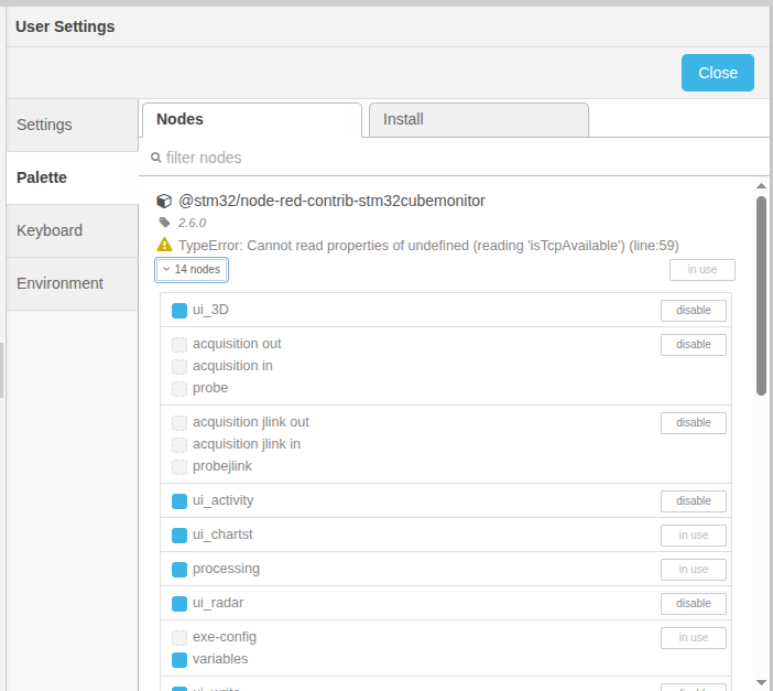

I run stm32cubemonitor, and then node-red is showing up an error of:
Cannot read properties of undefined (reading 'isTcpAvailable') (line:59)
I think this code underneath is all bundled into the distributable, so I can't debug what's actually going wrong.

The "isTcpAvailable" is part of the internal probe API of STM32CubeMonitor. The problem may be a race condition when the probe is loaded inside CubeMonitor.
As PCu1 says "It worked for several years using TCP, but now I’ve had to switch back to P2P.", it may me due to a change. It may be linked to the updates done in STM32CubeMonitor v1.11.0.
Can you try with the version V1.10.0 ?
Thank you
Stephane
hello,
I tried with the version 1.10, and it works again in tcp shared mode
As you mention, something is different with the last version.
Pierre
Thanks a lot for your test.
The issue should be fixed in the Q3 release. (1.13)
