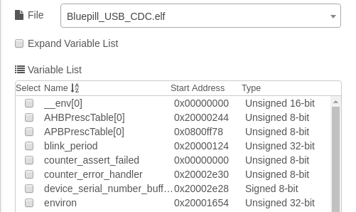

After loading the elf file variables are detected incorrect (wrong address an/or size)
Two examples with output of readelf
1) used in *.c file:
uint8_t counter_error_handler __attribute__((section(".internal_ram")));
> readelf Bluepill_USB_CDC.elf -s |grep error
1374: 20002e28 1 OBJECT GLOBAL DEFAULT 9 counter_error_handler2) used in *.cpp file:
static uint16_t blink_period;
> readelf Bluepill_USB_CDC.elf -a |grep blink
389: 2000052c 2 OBJECT LOCAL DEFAULT 8 _ZL12blink_periodin STM32CubeMonitor these variables are listed with incorrect address and size (blink_period) and incorrect address (counter_error_handler)
Is this an issue of using a c/cpp project ?

This is quite strange. I am surprised by the result shown.

A contemporary .MAP file might be definitive.
Generally I'd have more confidence in the Linker than the average ELF parser.

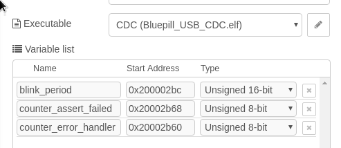

Hi Stephane,
thanks for your feedback.
According to your notes I've tried to reproduce the issue with a clean build. But I can't ;)
The addresses and sizes are now correct. Don't know whats going wrong the first time - therefore sorry for any confusion ...
> readelf Bluepill_USB_CDC.elf -s | grep blink
343: 200002bc 2 OBJECT LOCAL DEFAULT 7 _ZL12blink_period> readelf Bluepill_USB_CDC.elf -s | grep error
1208: 20002b60 1 OBJECT GLOBAL DEFAULT 8 counter_error_handlerBest regards,
