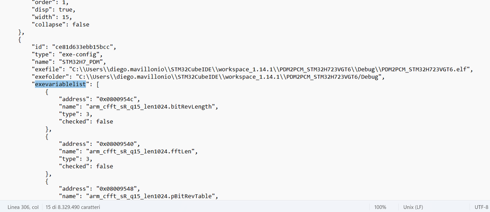

Hi, please can someone help me?
when I try to deploy I get the following error:
Spoiler
PayloadTooLargeError: request entity too large
at readStream (C:\Users\diego.mavillonio\AppData\Local\STM32CubeMonitor\resources\app\node_modules\raw-body\index.js:163:17)
at getRawBody (C:\Users\diego.mavillonio\AppData\Local\STM32CubeMonitor\resources\app\node_modules\raw-body\index.js:116:12)
at read (C:\Users\diego.mavillonio\AppData\Local\STM32CubeMonitor\resources\app\node_modules\body-parser\lib\read.js:79:3)
at jsonParser (C:\Users\diego.mavillonio\AppData\Local\STM32CubeMonitor\resources\app\node_modules\body-parser\lib\types\json.js:138:5)
at Layer.handle [as handle_request] (C:\Users\diego.mavillonio\AppData\Local\STM32CubeMonitor\resources\app\node_modules\express\lib\router\layer.js:95:5)
at trim_prefix (C:\Users\diego.mavillonio\AppData\Local\STM32CubeMonitor\resources\app\node_modules\express\lib\router\index.js:328:13)
at C:\Users\diego.mavillonio\AppData\Local\STM32CubeMonitor\resources\app\node_modules\express\lib\router\index.js:286:9
at Function.process_params (C:\Users\diego.mavillonio\AppData\Local\STM32CubeMonitor\resources\app\node_modules\express\lib\router\index.js:346:12)
at next (C:\Users\diego.mavillonio\AppData\Local\STM32CubeMonitor\resources\app\node_modules\express\lib\router\index.js:280:10)
at cors (C:\Users\diego.mavillonio\AppData\Local\STM32CubeMonitor\resources\app\node_modules\cors\lib\index.js:188:7)
The file.elf that I upload is 1930Kb, if I upload a file.elf of smaller dimensions the error does not exist.

Mavi
Associate II
I managed to solve the problem, I'll post the solution if it helps others...
in this file: "C:\Users\diego.mavillonio\AppData\Local\STM32CubeMonitor\resources\app\node_modules\body-parser\lib\types\json.js"
I changed the "limit" variable as follows:
function json (options) {
  var opts = options || {}
  //****** OLD *********
  //var limit = typeof opts.limit !== 'number'
  //  ? bytes.parse(opts.limit || '100kb')
  //  : opts.limit
  //******* NEW ********
  var limit = bytes.parse('10Mb')
  var inflate = opts.inflate !== false
  var reviver = opts.reviver
  var strict = opts.strict !== false
  var type = opts.type || 'application/json'
  var verify = opts.verify || false

Mavi
Associate II
I'm sorry, I'm not a javascript expert, but it seems that the limit is passed to him as an argument... it's not defined in these files or am I wrong?

I noticed that in the "exe-config node" if I select "expand variable list" the deployment gives an error while if I don't select it it proceeds normally...
If I export my "Flow" with the complete variable list I get a.json file containing the entire list of variables, not just those selected by me... Perhaps I exceed the "exevariablelist" limit
