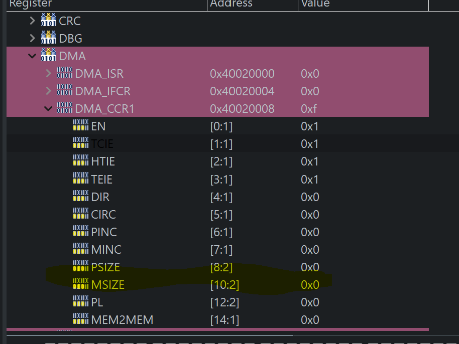

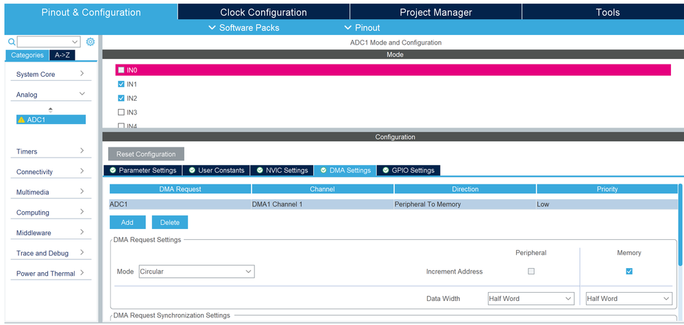

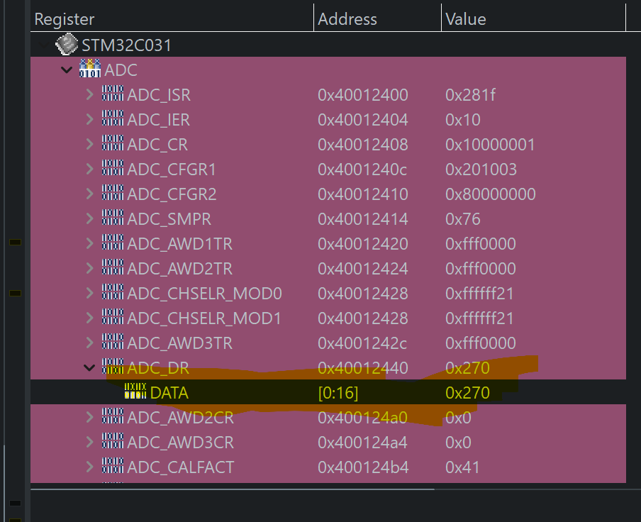

I managed to eliminate the fault at the start time so now I can run conversions but the array buffer adc_result is still not filled with any value. I checked into the registers and it seems to me that the ADC is working in fact fine. I can see the value of the last conversion inside the ADC_DR DATA register at every iteration changin while i move the potentiometer.
Then when I check the register of the DMA I see things that seem strange to me, for instance the MSIZE bits inside the CCR1 register should be 01 for half word size configured in the MX where i see 00.
Dont know it seems to me that it's a bit early for these C0 drivers....
MINC should be set, too.
Next step is to set a breakpoint at the beginning of function which sets up DMA and observe, why are those value set incorrectly.

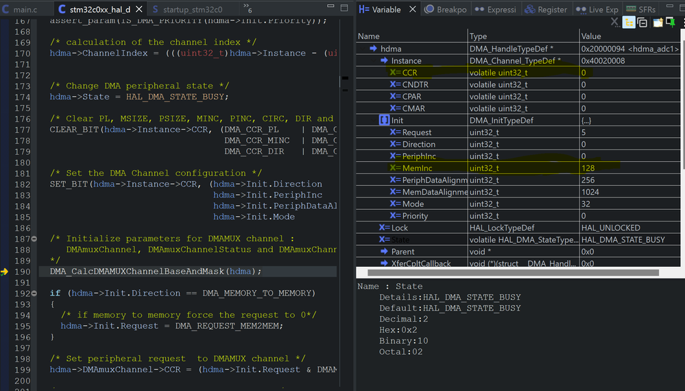

2023-02-20 3:12 PM
I did at the DMA init function and what I see, for instance, is that the hdma structure contains correctly values, for instance MINC one... but after the BITSET the CCN register still remains completely empty.
I even try to execute a simple bitwise operation to set one single bit straight to the CCN register but again it stays empty. So my guess is that the issue is there, maybe the peripheral is simply off cause something goes wrong in setting up the clock or i don't know... here I stop cause it goes too deep in the st driver and I let them debug.

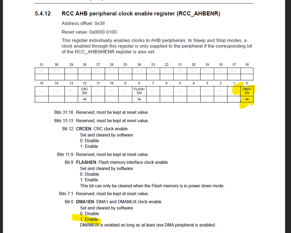

2023-02-20 8:23 PM
This typically happens if the DMA does not have enabled clocks in RCC. Check RCC registers content. Also you should see code to enable the DMA clock somewhere at the beginning of that initialization routine.

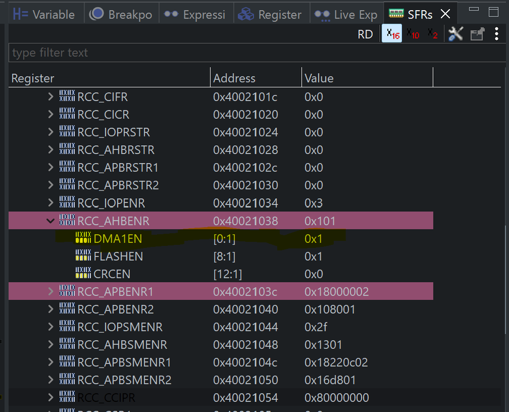

2023-02-21 4:51 AM
Nope, the AHB enable register seems correctly set for DMA1
Filippo

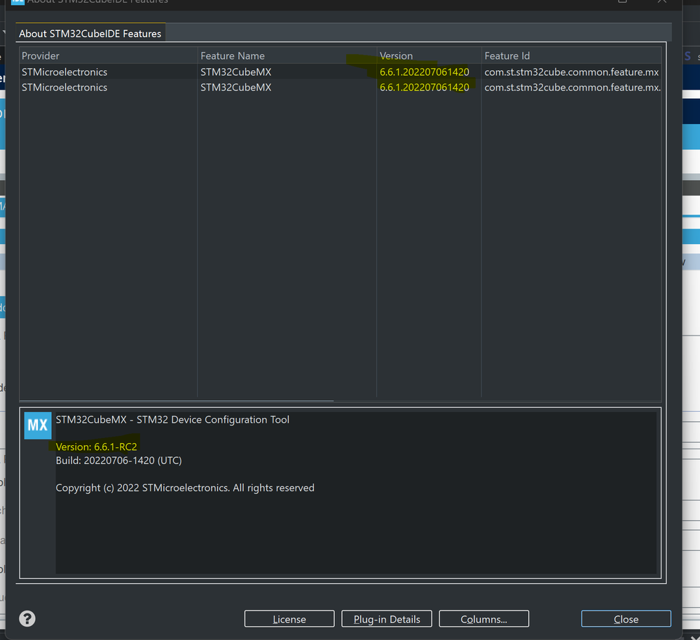

yep! you got it man!
Thanks so much!
Only issue i have is that the post you linked is saying that he issue was fixed on version 6.4 of MX where I am at version 6.6... so clearly a vicious regression!
Cheers,
Filippo
2023-02-21 5:19 AM
Hi Filippo,
it appears that there's already v6.7 https://community.st.com/s/question/0D53W00001yFCKTSA4/stm32cubemx-670-released
