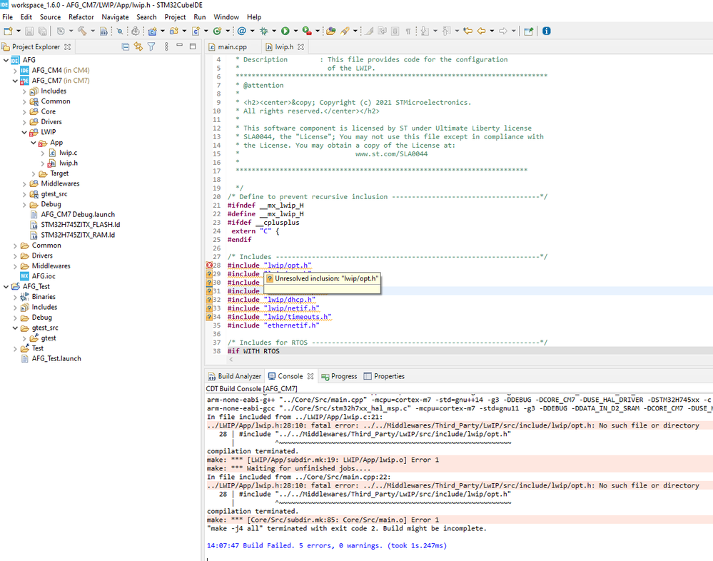

Hello @Jvan .10 it seems from picture that header file is not properly included in project.
If Its possible you can share your project folder here to try.
Saurabh
