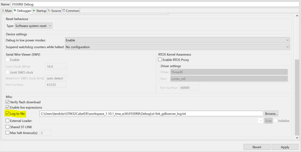

Could you also supply the log-file? It will be created if option “Log to file�? is enabled in the debug settings.

Thank your for your answer.
I put the log file in attachment. It seems the problem comes from a command "vKill" which is not supported?
