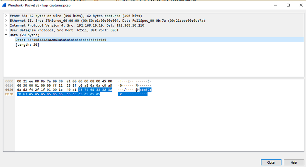

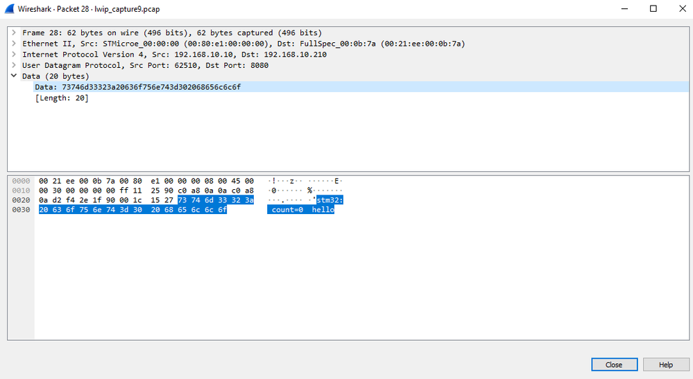

Only on the Tx path, we are observing Ethernet packet data corruption, for the first Tx packet the data will be fine but from the next packet onwards data is corrupted, we are using socket API for communication from RTOS thread.
Second packet,
We have checked with UDP-based LwIP API and this Tx corruption is not seen, with socket-based LwIP API there is data corruption.
I have seen the following points, but not sure what change is required for low_level_output()
lwIP driver Tx missing D-cache clean operation.While a newer ST provided code solely relies on MPU to configure specific memory regions as non-cacheable, it is not a complete solution for Tx buffers. PBUF types PBUF_ROM and PBUF_REF can point to arbitrary memory addresses and therefore still need D-cache clean operation to be performed.
If this can cause by any other reason please let us know.
