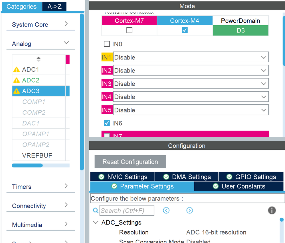

2022-03-14 10:03 AM
Hi TDK,
The ADCs are assigned to the M4:

Update: I've looked in the FSRs and can see the ADC3 peripheral clock is enabled (Bit 24 of AHB4ENR). So the generated code is enabling the ADC clock somewhere.
Is there a way of finding out what causes this HAL_ERROR? I'm running out of ideas of where to look.
Thanks,
Adrian.
