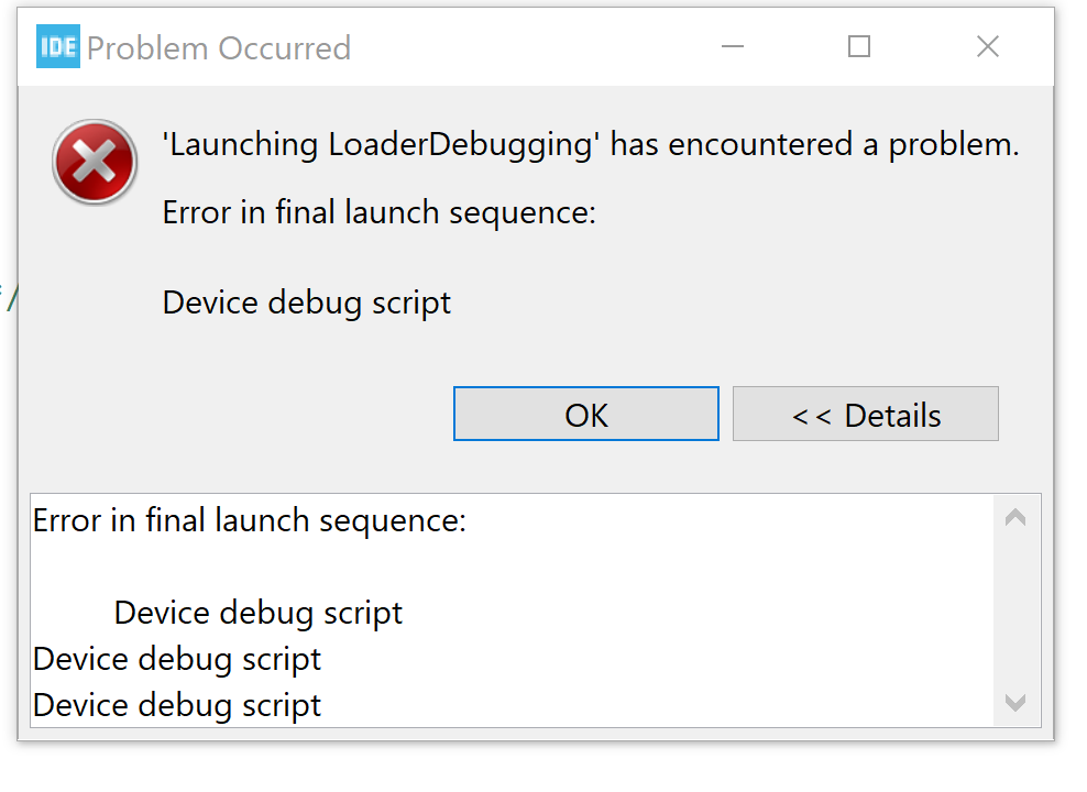

2022-03-13 9:55 PM
NUCLEO F767ZI Board
STM32CubeIDE 1.8
This problem confused me several days and still not fixed currently.
Any help would be appreciated!
!ENTRY org.eclipse.cdt.dsf.gdb 4 5012 2022-03-14 15:20:29.503
!MESSAGE Error in final launch sequence:
Device debug script
!STACK 1
org.eclipse.core.runtime.CoreException: Device debug script
at org.eclipse.cdt.dsf.concurrent.Query.get(Query.java:112)
at org.eclipse.cdt.dsf.gdb.launching.GdbLaunchDelegate.launchDebugSession(GdbLaunchDelegate.java:251)
at org.eclipse.cdt.dsf.gdb.launching.GdbLaunchDelegate.launchDebugger(GdbLaunchDelegate.java:108)
at org.eclipse.cdt.dsf.gdb.launching.GdbLaunchDelegate.launch(GdbLaunchDelegate.java:96)
at com.st.stm32cube.ide.mcu.debug.launch.DSFDelegate.launch(DSFDelegate.java:306)
at org.eclipse.debug.internal.core.LaunchConfiguration.launch(LaunchConfiguration.java:803)
at org.eclipse.debug.internal.core.LaunchConfiguration.launch(LaunchConfiguration.java:716)
at org.eclipse.debug.internal.ui.DebugUIPlugin.buildAndLaunch(DebugUIPlugin.java:1021)
at org.eclipse.debug.internal.ui.DebugUIPlugin$2.run(DebugUIPlugin.java:1224)
at org.eclipse.core.internal.jobs.Worker.run(Worker.java:63)
Contains: Device debug script
!SUBENTRY 1 org.eclipse.cdt.dsf 4 0 2022-03-14 15:20:29.503
!MESSAGE Device debug script
!SUBENTRY 2 com.st.stm32cube.ide.mcu.debug.launch 4 0 2022-03-14 15:20:29.503
2022-03-15 3:18 AM
Tested CubeMX-generated project and fount it works.
Compared .cproject file with a CubeMX-generated .cproject, and found some incorrect paths.
Thanks TDK for your help.
2022-03-14 6:49 PM
If you create a new CubeMX-generated project for that chip, does the debug work for it?
2022-03-14 11:57 PM
I'll give it a go, and put the result here later.
2022-03-15 3:16 AM
2022-03-15 3:18 AM
