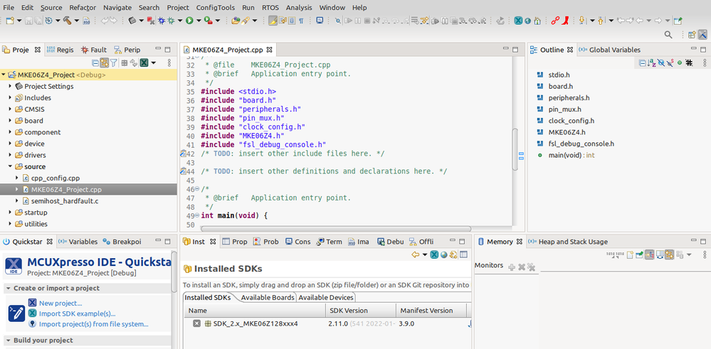

2022-03-12 1:46 AM
I'm not sure if it's a bug or not but the MCUXpressoIDE works as expected. In this case If you create a C++ project the IDE generates a .cpp main file (MKE06Z4_Project.cpp). This is a natural workflow to me without doing workarounds.

In this case it may be more appropriate to speak of 'very' nice-to-have feature.
The MCUXpresso libraries are also written entirely in plain C and if you create an MCUXpresso project in C++ you can call them from main.cpp without limitations. On the other hand, if you create a C project you won't be able to call libraries/functions written in C++.
Basically, creating a project in C++ should allow calls to C/C++ functions/libraries from main.cpp while a project created in plain C (main.c) will only allow calls to library functions written in plain C. I think no one will feel upset about this.
Despite creating a C++ project the STM32CubeIDE only generates a plain main.c instead of main.cpp. This makes it impossible to call C++ functions/libraries from main.c. I would have no problem renaming the file once but if I do multiple pinmux/peripherals updates they all generate a main.c and this workflow is no longer efficient at all.

2022-03-13 11:58 AM
@Pavel A. It is much easier than it seems. If you create a project in C++, the STM32CubeIDE simply has to generate a main file with the extension cpp instead of c. The rest of the code stays the same as in C and you don't need to do anything else. Then pinmux and peripheral updates modify the main.cpp file and voila. Everything flows. At least that's how MCUXpressoIDE does it. I don't know if other IDEs do the same, but it is true that many offer little support for C++.
