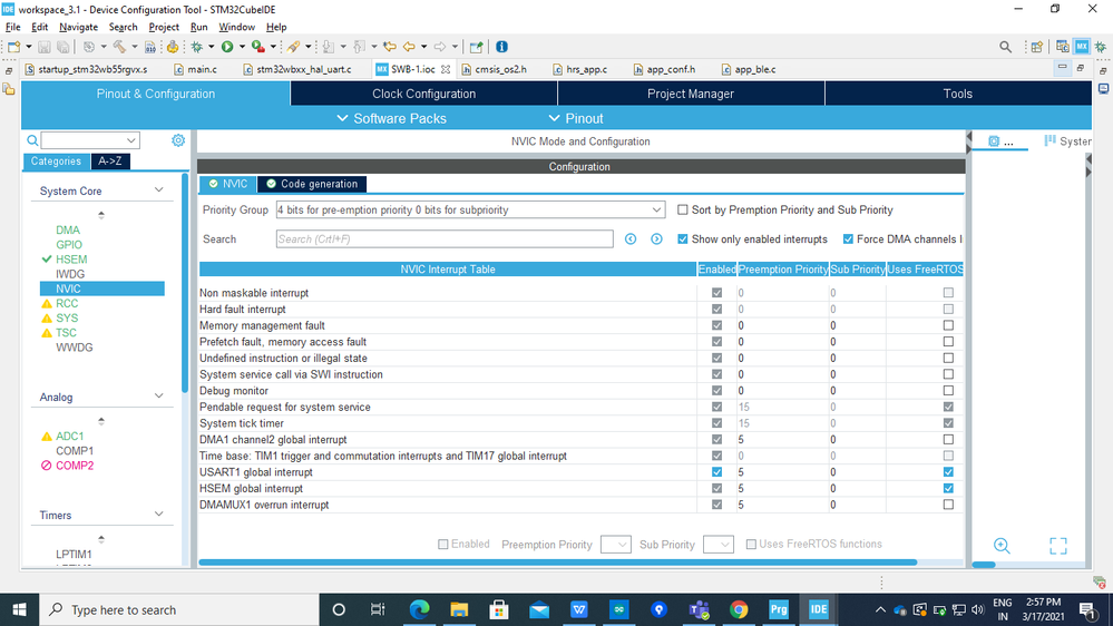

Thanks for reply @KnarfB We just configured all peripherals, BLE, RTOS with single default task with priority of "osPriorityNormal" which is 24. We found three more RTOS tasks in auto generated code itself.
1. "HrsProcess()" which is in hrs_app.c with priority of "osPriorityNone" which is 0.
1. "HciUserEvtProcess()" which is in app_ble.c with priority of "osPriorityNone" which is 0.
1. "AdvUpdateProcess()" which is in app_ble.c with priority of "osPriorityNone" which is 0.
please find the image, I attached all active Interrupt's priorities.
