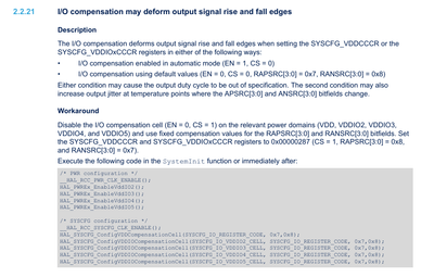

Please try to disable the I/O compensation cell (EN = 0, CS = 1) on the relevant power domains (VDD, VDDIO2, VDDIO3,VDDIO4, and VDDIO5) and use fixed compensation values for the RAPSRC[3:0] and RANSRC[3:0] bitfields as mentioned in the errata sheet.
