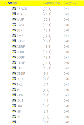

I am using UART with DMA to communicate with nRF52833 with hardware flow control enabled. But while receiveing data, I get continuous interrupts and void USART2_IRQHandler(void) is called continuously.

}Below is the screenshot of ISR register.

Do you have enabled interrupt upon CTS in USART_CR3.CTSIE?

As already mentioned by @Community member , some flags in ISR could not be cleared by write operations in ICR. For instance, TEACK, REACK are only status bits and are not generating interrupts, they could not reset by ICR updates.
Regarding TXE bit, it is cleared when some data is written in TDR.
WHat is the content of your TXEIE bit in CR1 ? If TXEIE is enabled, TXE set to 1 in ISR will generate interrupts until TXEIE is 0 or TDR ids filled with data to be sent ...

No. I had only enabled RXNE interrupt.
