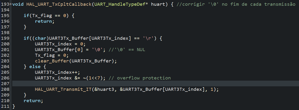

On the image below you can see my Transmit_Callback that I've been using in all my programs before starting to use FreeRtos.

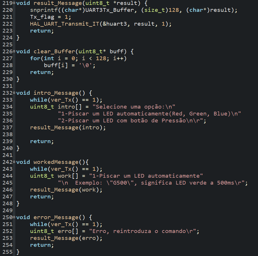

0693W00000NrEkzQAF.pngThese are the functions that I call on the tasks to send the messages

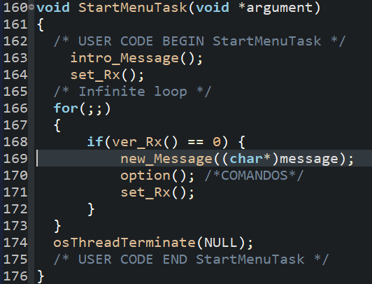

0693W00000NrElJQAV.pngThis is the Menu task:

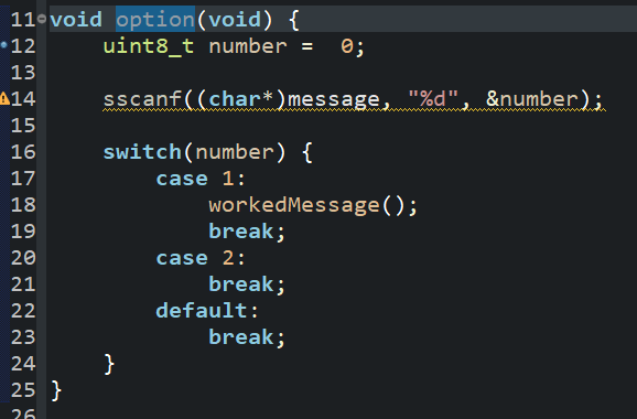

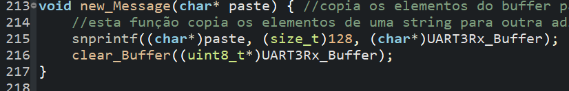

0693W00000NrElOQAV.pngThis is the new_Message function and the option function
0693W00000NrElnQAF.png0693W00000NrEo3QAF.pngThe set_rx funtion is to make the Rx flag to 1, in order to let the rx_callback recieve the characters from the user.

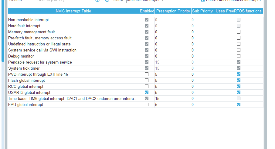

How do you configure the priority of interrupts? Make sure you have configured the priority correctly.

Hello @Walid ZRELLI​ ,
Bellow you can see my interrups priority, I haven't changed them:
0693W00000NrGMpQAN.pngAbout the stack overflow, I dont really know how to verify that on the STM32CubeIDE.

[EDIT]: I've removed the workedMessage() function from the option() switch case, to see if the tasks would still be interrupted and they do, so maybe isn't an issue caused by the UART (?), because when I tried to call the workedMessage function in the menuTask() condition without any option verification it worked and printed all the characters and didn't stop the tasks
 [EDIT2]: I was wondering if the problem came from the Recieve, but I tried to echo my messages and it worked just fine, is something in the option() function that I can't have?
