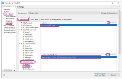

Hello @m1ng and welcome to the Community :),
Please make sure that the DSP library path is correct.
From Project menu or File menu, go to Properties > C/C++ Build > Settings > Tool Settings > MCU CGC Linker > Libraries > Libraries (-l) > Add and insert the following library: "arm_cortexM4lf_math". as shown in the below figure
I recommend you to follow the steps shared in How to integrate DSP Libraries on STM32 project? An example using STM32F429 FAQ to integrate correctly the DSP library in your project.
Please let me know if the issue is solved or not.
Thank you.
Kaouthar
