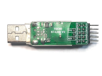

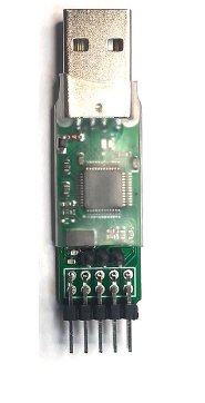

Peter BENSCH
Please upload a photo of your ST-LINK.
Regards
/Peter

Hi Peter
Glad to get in touch. Iam using ST-Link from 7SEMI is a USB-based programmer and in-circuit debugger designed for STM32 microcontrollers.iam herewith attaching the photos of the ST-link . Kindly go through.
Thanks and Regards
Neelima S

Peter BENSCH
The topic has been discussed very often in the community: It is an illegal clone of an ST-LINK with a different MCU, whose behaviour ST does not know and therefore cannot support. Please buy an original ST-LINK, then you won't have such problems.
