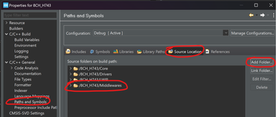

One issue is that the middleware directory is not set up as a source directory. You can do that here:
Doing that will still leave this error:
../Middlewares/Third_Party/LwIP/src/include/lwip/apps/httpd_opts.h:388:27: fatal error: fsdata.c: No such file or directoryUnclear how to solve that as fsdata.c is not a file that exist in the project as far as I can see.

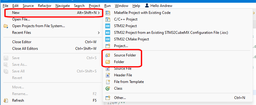

@TDK wrote:One issue is that the middleware directory is not set up as a source directory.
@Saeedn823 If you look in the IDE's Project Explorer, the Source folders are the ones with the little 'C' emblem on them:
In this example, you can see that 'Core', 'Drivers' and 'cc1125-demo' are all Source folders, but 'Debug' is not.
The Compiler only looks for files to compile in the Source folders - the Compiler ignores other folders.
When you create a new folder, the IDE gives you separate options for Source folders - distinct from other folders:
