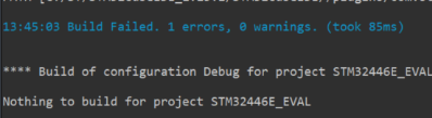

I have used an example code of CAN loopback using nucleo STM32F446RE
the location is
C:\Users\.........Your User Name.....\STM32Cube\Repository\STM32Cube_FW_F4_V1.27.1\Projects\STM32446E_EVAL\Examples\CAN\CAN_Loopback
Unable to bulid this project and it is showing Nothing to build for project STM32446E_EVAL.
how can I solve this problem

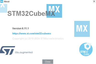

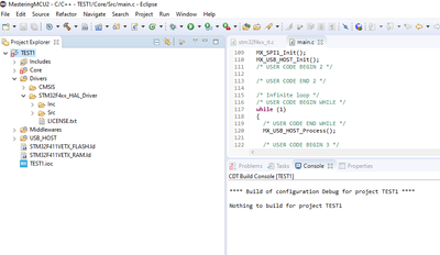

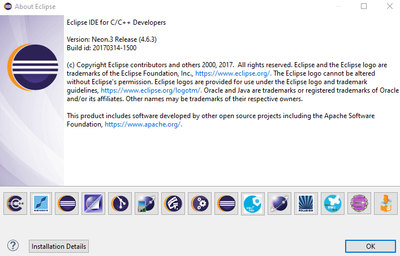

2024-10-01 6:02 AM
I am using STM32SystemWorkBench with STM32CubeMX.
I am using STM32F411E-Discovery Board (STM32F411VET6U).
I have created a sample project for STM32F411E-Discovery board using STM32CubeMX and imported that project using STM32SystemWorkBench and tried to build it.
As soon as I tried to build it, I am getting below message. I am new to these tools and please let me know incase I am missing something here.
Please refer below snapshots for version details.
Version detail of STM32SystemWorkBench
Version detail of STM32CubeMX
