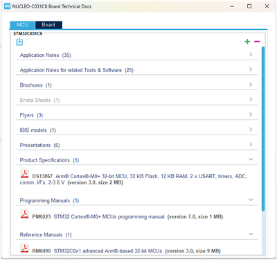

Finding the MCU documentation is very easy with CubeMX. (less so with CubeIDE).
In CubeMX just select Help-> Docs and resources. Then select MCU tab. And here you are, all the PDFs for the MCU selected in the CubeMX (.ioc). On the board tab: all documents for the board (if available).

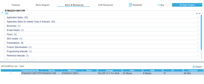

Hello @AdilMC and welcome to the ST Community.
For the Documents that are related to the tool (STM32CubeMX,IDE,...) they are all available only on the webpage of the Product on the ST website. For the documents of the product that you are using, they are all available throw the standalone version of CubeMX:
Best Regards.

2025-01-22 1:56 PM - edited 2025-01-22 1:58 PM
