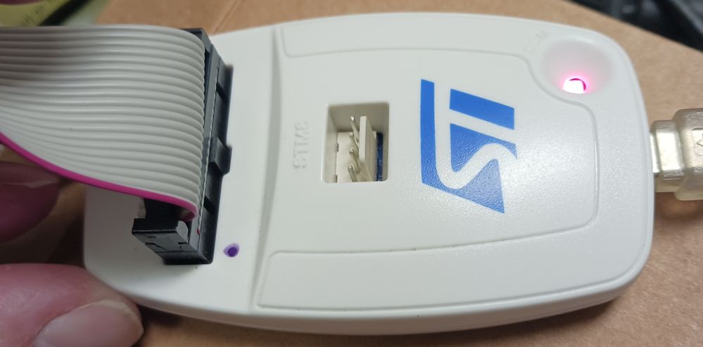

2025-01-22 8:16 AM
Unfortunately saying some is correct when it does not work is not compelling..
The ST-LINK in the picture looks to be wired incorrectly. The buffers require pin 1 or 2 of the 20-pin header to have VTarget.
https://community.st.com/t5/stm32-mcus-security/unable-to-detect-target-stm32h503/td-p/764700
