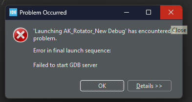

I am trying to upload my code using ST Link(SWD)into a custom board with an STM32 Core. I am using serial wire debug for programming. So I am getting the above shown error messages. If anyone have come across this issue, please help me resolve it.

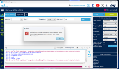

I tried uploading the code using STM Cube Programmer also. I am getting the above error.!

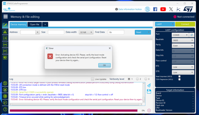

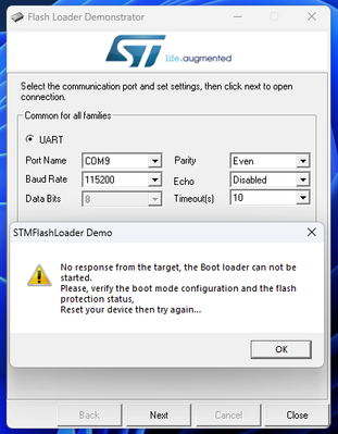

I am still unable to program my custom board using the i.ST-LINK, ii.USB to UART(TTL), iii.another Evaluation board debugger IC. I don't know what the issue is. I have tried connecting the BOOT0 Pin to logic high and logic low, both. Kindly help me with the same.
