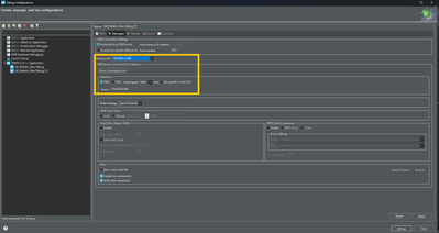

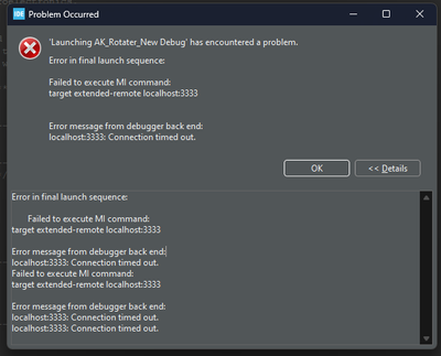

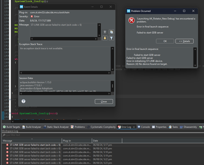

I am trying to upload my code using ST Link(SWD)into a custom board with an STM32 Core. I am using serial wire debug for programming. So I am getting the above shown error messages. If anyone have come across this issue, please help me resolve it.

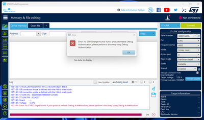

I tried uploading the code using STM Cube Programmer also. I am getting the above error.!

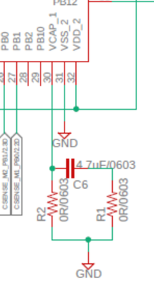

Perhaps pins are not wired up correctly. Can you share a schematic? How is the board connected to the programmer specifically?
Looks like it's detecting a voltage. That's good.
2024-08-05 6:35 AM
Focus on your hardware implementation, doesn't appear viable.
Check power, especially VDDA/VSSA
What STM32? The make a handful of different ones, with different expectations.

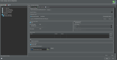

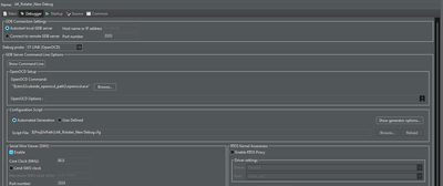

I tried programming the custom designed board using
i.) an external ST-LINK and also
ii.) using the debugger IC in the evaluation board(STM32L496ZGT6).
Both gave the same error as i mentioned in the previous posts.
NOTE:
I am able to program an Evaluation board without using the On-chip debugger IC by using an external ST-LINK. But not able to do the same with the custom designed board. Not able to find the underlying cause.!
In the debugger configuration I am able to detect the IC of the custom board. I am using Evaluation version debugger IC of STM32L496ZG to program a STM32F423RH. I am able to detect this IC when I change the setting to Segger J Link. I dont know why this happens.

What's going on here? VCAP should only have the capacitor to ground. If you don't load R2, this should work.
Why does VSS_3 have a resistor to ground? It'll probably work, but doesn't make a lot of sense to me.
I don't see any other issues, although you don't show VDDA generation. Assuming that's fine.
SWD does not need VCC or NRST, but they can be useful to have.
