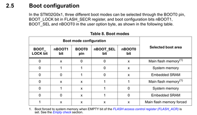

The BOOT0 pin state is ignored on this microcontroller by default. You need to change the option bytes if you want different behavior.
On the first boot, since flash is empty, it boots into the bootloader. After that, it boots into user flash.
To recover, you will need to change the option bytes using a SWD programming connection.

1) After it's already programmed, yes. If not yet programmed, the bootloader could do this via STM32CubeProgrammer.
2) AN2606 describes how to get into the bootloader. The reference manual describes default option bytes.
3) Set BOOT_SEL = 0 to have the BOOT0 pin be sampled on startup rather than the nBOOT0 bit.
