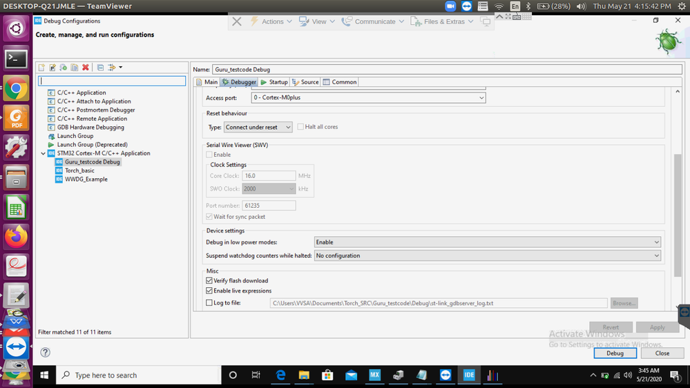

The serial wire viewer option is disabled, i can't enable the serial wire viewer option in the stm32cubeide. Can you give some suggestions ?

Cortex M0 does not support serial wire output.

Thanks for the input Pavel A.
