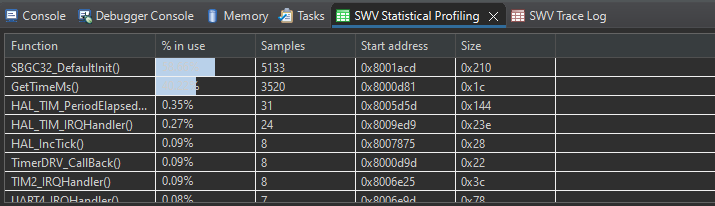

See the image below:
As you can see - the cells that has some higher percentage are almost unreadable. It seems to be using the same colors for the 'normal' eclipse debugging table-like features such as Variables, Live Expressions, Expressions, etc.
I tried looking for the highlight color and messing with settings but could not find anything that affects it. I even went out and made a Google Sheets with all colors listed in the settings file to try to match that highlight color with no success.
2023-06-20 1:45 AM
Using Darkest Dark as suggested here sort-of solves the problem.
The text is indeed readable but the highlighted area to represent the percentage is not visible unless selecting the cell. Doesn't really matter though.
