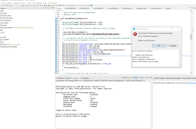

I have checked connections and assured that everything is set up correctly. When I run the below code, I cant see anything on serial console.
Does anyone have any idea about the root cause ?

2024-03-20 12:57 PM
which board ?
custom/ which cpu ?
What you connect to ---> usb ?
2024-03-20 1:52 PM
Are you sure the code is running?
Can you toggle a GPIO/LED at the same time?
Configuring the right pins, code not shown, connectivity not diagrammed. Hard to diagnose with the imagination.
Can you look at the signals with a scope?
2024-03-20 11:00 PM
I have added HAL_GPIO_TogglePin(GPIOD, GPIO_PIN_14) to check if code is actually running, you are right that it doesnt run at all.

Sorry guys.
My board is STM32F407VG-DISC1.
I am encountering an issue now that is I cant connect to the board. Please see the error I get below.
2024-03-21 12:46 PM
I have updated the ST Link firmware and issue disappeared. I can test that UART is working, I have just written a simple code to check and I can see via serial console that UART is fine.
