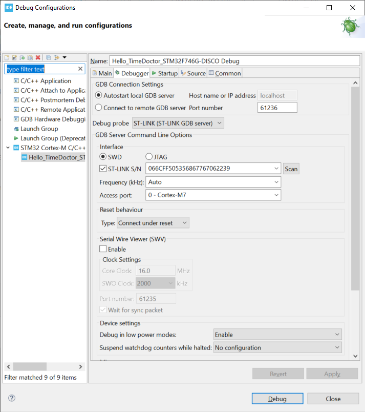

That's not an issue. You can change the port in the Debug Configuration. You should also scan for ST-LINK Devices and assign fixed serial numbers (=fixed ST-LINK devices) to each Debug Configuration. See picture:

Change the port.... so easy !!!
Thx, SOLVED !
